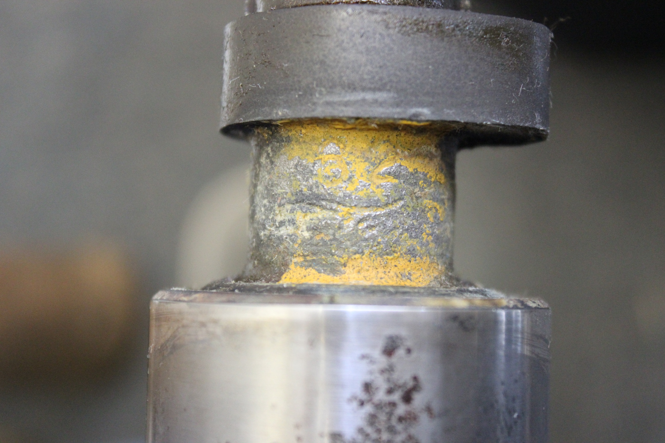

There are some other markings I did not notice before. There is a yellow paint marking highlighting the other marks. They appear to be a fomoco logo with either 32 or 82 above it. Any clue??

Does this info tell you anything about what the cam is?
Those markings do not mean anything to me.  Reverse engineering the camshaft specs either by using a Cam Doctor or measuring the camshaft lobe profiles within an engine would tell more about the camshaft at this point.  If I could borrow the camshaft, I would be interested in reverse engineering the specs from it.
