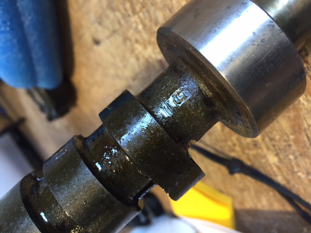

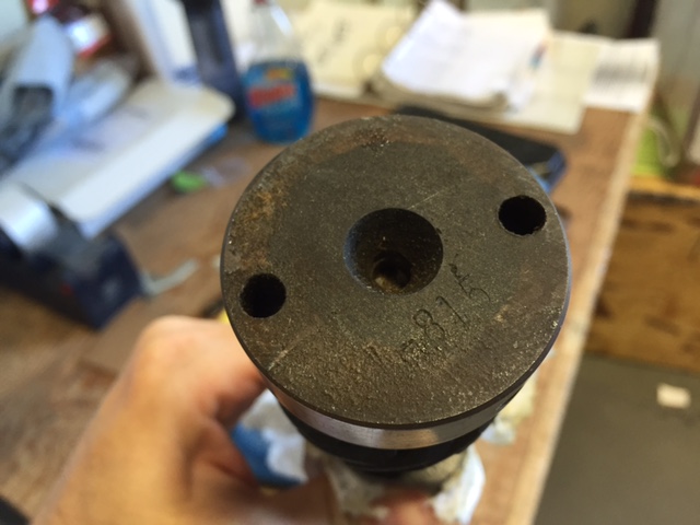

OK I took the cam out and inspected it for markings. On the cam end, it is stamped I-815. I also found markings EDB near the opposite end. Does this tell us anything? See the attached pics.
Mike
Oldmics
Posts: 710, Visits: 78.1K
Looks like there might be some additional markings on the EDB end. On the side of the bearing journal surface.
Might have a FoMoCo script and other markings.
Any chance for some additional hi definition pictures?
