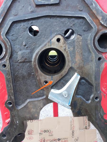

This is a photo that the OP had posted many pages ago, what is the silver trough thing? not the oil hole with the arrow pointing to it, but the silver item that looks like it is made of sheet metal and is attached with the one phillips screw/bolt ?

Oil trough for timing chain with oil coming from the lifter galley.

is that a stock part? I have never seen one.

The timing chain oil troughs were factory installed on the 1954-1956 Ford Y’s.  I have come across a few 1957 engines with them but by the end of 1956 they were being phased out as a cost cutting measure.  Here’s another picture of the oil trough.
