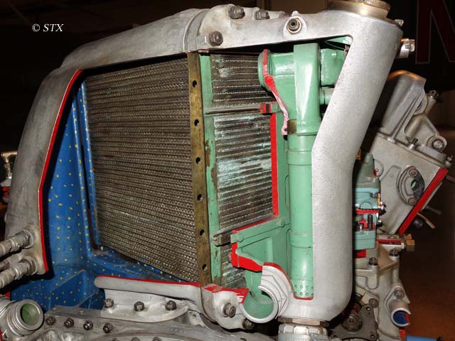

The hydroplanes also used the bigger Rolls-Royce Griffon 2240 cu in, a "Y-Block", 2000+ hp Smile. Griffon is similar to the Merlin and used in airplanes such as the Spitfire, and was later also put in a modified P-51 Mustang for competition.
For inspiration Wink, I took a picture of the liquid/air intercooler for the Griffon, which is cut for visibility. The blue color shows air/fuel mixture, and the green color is the water/glycol part.
Before making a homemade intercooler, think of the forces. If my calculations are right, a 10x10 inches surface or joint will at 28 psi boost create a force of over one ton w00t, that can explode right into your face Sad.
