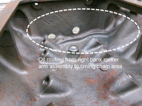

pcmenten (4/5/2009)
.....the passenger side overflow tube just directs oil down a hole in the head. Perhaps an extension of that tube that continues through the valley and out the front, over the chain would be helpful.
The passenger side rocker overflow tube does direct the oil to an engineered path in the block to the timing chain area.  When examining the front area of the lifter valley in a Y block, you’ll see a designed and cast in path or channel where the oil from this particular overflow tube gets redirected to the timing chain area.

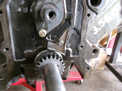

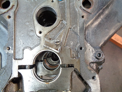

pcmenten (4/5/2009)
Speaking of over the chain, perhaps it would be helpful to modify the front of the block to ensure that oil lands on the chain, not just flow down past the chain.
The aforementioned oil trough bolted on the front of the block does a good job of directing the oil to the lower timing gear sprocket and chain which then gets carried back up to the cam gear.  This trough was eliminated in 1956 but I’ve built a jig that allows these to be put back on the later model engines in the correct factory specified position.  Here’s a couple of pics of the oil trough for those that have never seen one.
