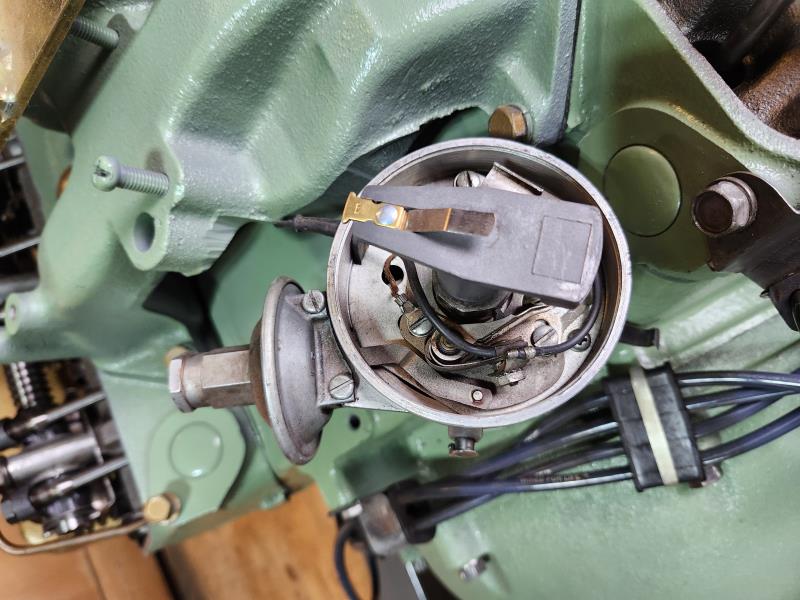

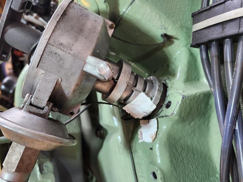

This is as far as it wants to drop in. What do I need to do to get it down all the way?
