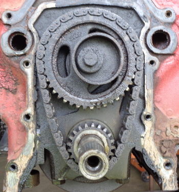

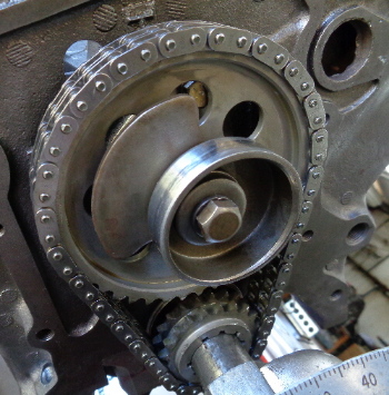

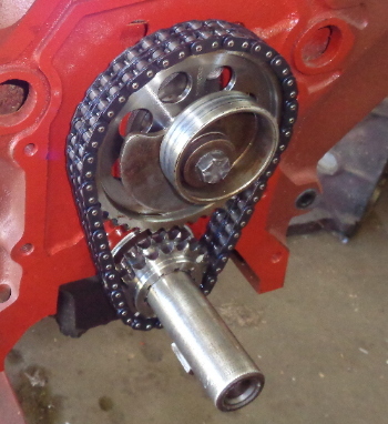

Here are some pictures showing the fuel pump eccentric on the FYB engines.
http://forums.y-blocksforever.com/uploads/images/b203e68f-73c6-4480-bd76-a979.jpg
http://forums.y-blocksforever.com/uploads/images/b7da0aa5-77a2-4f0f-9189-e919.jpg
http://forums.y-blocksforever.com/uploads/images/5e0e4fbf-f1ec-4659-97a1-2dd3.jpg
http://forums.y-blocksforever.com/uploads/images/cbb1699c-83f4-4ecc-8b42-575c.jpg

And thanks for the photos, Ted...VERY helpful.
