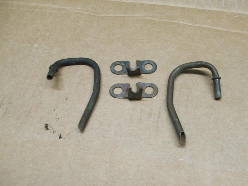

You're so right, with the valve cover off and engine running in a matter of seconds the oil is running over the lip on the head.
Tim Quinn
Posted 6 Years Ago
Supercharged (633 reputation)Supercharged (633 reputation)Supercharged (633 reputation)Supercharged (633 reputation)Supercharged (633 reputation)Supercharged (633 reputation)Supercharged (633 reputation)Supercharged (633 reputation)Supercharged (633 reputation)
Posts: 266, Visits: 3.5K
Ted,
We think we found the problem. The oil return tube at the back of the head is missing.
We're looking for replacements
Thx for tour input,
Tim in Florida

Tim I have some spare tubes,send me a pm with your address  Carl

I have been reading this thread and understand the oil tube is missing ,my question is will this missing part increase the volume of oil so much that it will flood the head ,so much it will cause the smoking , or is it possible the head gasket was not properly installed and with the valve cover on the oil is truly flooding the head. I watched the video on YouTube where the rockers are pressureized and the is a large amount of oil it properly drains away and there is no smoke from the engine. I am no expert by any means but the video on YouTube seems pretty definitive. Seems like large amount of oil is ok if it drains properly.
darrell
Posted 6 Years Ago
Last Active: 3 Months Ago
Posts: 455, Visits: 22.2K
someone may have turned the groove to deep in the cam.in that case putting restrictors in the rocker stand will fix the problem.and again this may not be the problem.
