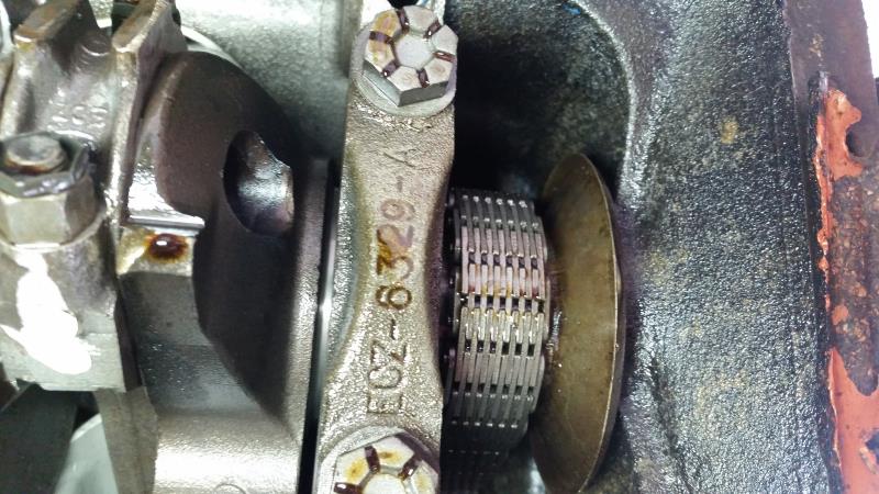

The Main Caps read ECZ-6329-4

Posts: 150, Visits: 1.4K
That's a 312.
