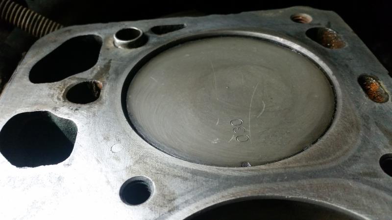

I got my felt pro full engine gasket set and decided to do the head gaskets just for shits and giggles. Seems that the motor has already been run through and has pistons that are .030 over. Has anyone dealt with 312s bored .030 over? Any significant increase in performance?
Also I have been looking online for the torque sequence on the head bolts. Does anyone have that on paper? Nice to finally make it through the holiday season and get back to late nights in the garage.
Zach.
By miker - 9 Years Ago
Lots of .030 over .060 over and more here. A little increase in compression, but not a lot. I don't know how to check the deck height (someone will). Bit there's a pad on the head that if mic'ed will tell you what's been milled. Someone will chime in with that, or you can run a search. There's also a lot of info on making sure the oil passages to the rocker arms are clear, and various mods for that. And the valve seals, etc. If the heads are off, nows the time to look it up and do what you'd like. Also, note the head gaskets go on with the square corners forward. Backwards causes cooling problems. There's a couple good y block books on Amazon, one new. Might pick one up.
"Shits and giggles". I remember that.
Any shop manual will give the torque order, or the Hot Rod Reverend has them on CD. Basically , center out, alternating left to right.
