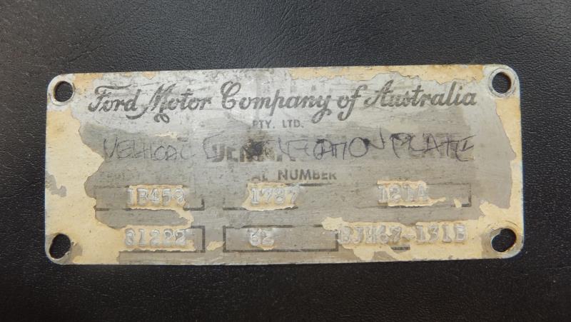

I have a 57 mainline ute, have found a number on top of  R/H front of chassis member    VOB100    and on the underneath of round cross member under motor it has   4757 stamped on it. Have taken body off ,blasted and painted chassis,done all the rust etc replaced as much as possible with new parts,motor, auto,diff and front end rebuilt, would like to make it a bit easier to put it over the pits, I heard it's a bit tougher up here at the rego dept in Darwin... This is the data plate that was on it when i bought it                                                                                   ------------------------------------------------------------
   SERIAL           BODY          MODEL
   1B458              1787              121A
   PAINT             TRIM                   ?
  81222                62            BJH67-131B

OzMainline (10/11/2014)
Woody, I have your answer.
Serial Prefix 1G.2.59 = made in Geelong. February. 1959
Body 426G = 426th Customline/Mainline body out of Geelong that year (Open to conjecture)
Model 123A  = Utility, Geelong
Paint 2.2.2.2 = primer brand . Champagne. Champagne. Champagne
Trim 58 = Red
You should also have a Serial Number = number of vehicles out of Geelong that year( including Zephyrs etc)
Trim 58 = Red
All this info has come from a member of a Facebook page I started called Australian Customlines and Mainlines.
