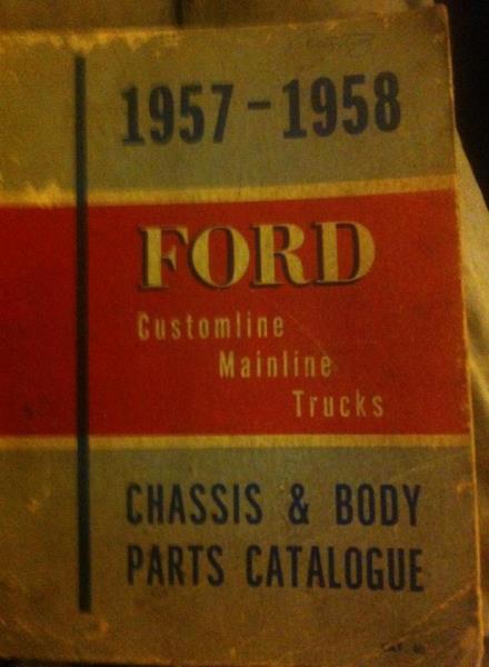

Does anyone know where Parts Catalogs,Shop Manuals etc can be purchased for the Australian Utes 49-59?There must have been unique Parts Books for these Cars as they would not have been covered in the Canadian Parts Catalogs?
By OzMainline - 12 Years Ago
There is an Australian book, but it has no Vehicle identification information other than pictures of vehicles. Very hard to come by now, especially in good condition. I was lucky enough to get one off ebay this week for a very cheap price.http://forums.y-blocksforever.com/uploads/images/17b110a2-45e3-4c18-988d-349c.jpg
