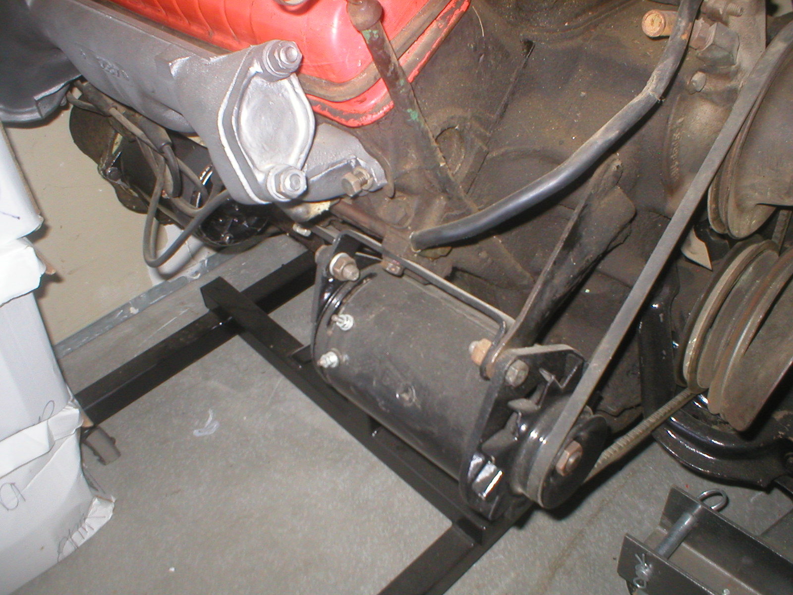

In 1954 and 1955 Ford made a heavy duty 50 amp 6 volt generator that was used on Ford police cars as well as Mercurys and Lincolns with air conditioning. There was also a matching 50 amp regulator that went with the generator. I have this 50 amp generator on the engine that came out of my 1954 Ford Mainline California Highway Patrol police car. The 50 amp generator is about an inch longer in length than the standard 35 or 40 amp Ford/Mercury generators and requires a special upper mounting bracket. If they made a 50 amp generator/regulator in '54-'55 for police and air conditioned cars there would seem to be little doubt that they also made 12 volt versions for post '56 cars although I don't have a '56 and later Chassis Manual to verify this. Alan S. Freeman
