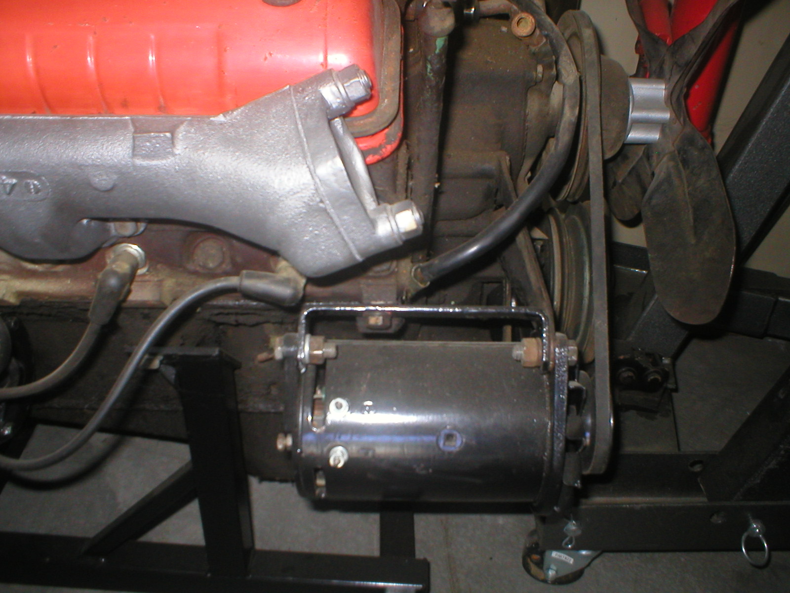

DualQuad...here are two pictures of the 50 amp generator on the engine that came out of my '54 Ford Mainline police car. The 50 amp looks pretty much like the 30/35 amp except that the case is about an inch longer. Alan S. Freeman

Hey Allan,
Thank you for taking the time to post the pictures....Looks good :-) Say do you think you could measure the diam. of the stud that's on the back plate? Typically it's a 5/16" stud.... Thanks Allan for your time :-)
