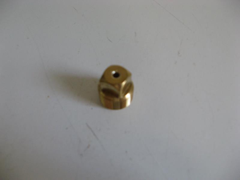

I read where Ted and others recommend a ristrictor with a 3/16 orifice in the bypass tube. Can this modification be made in isolation or do I understand that a hole (s) must be drilled in the thermostat? Does this (these) modifications require a specific thermostat?

Hi Mark, for the restrictor in the bybass hose use a 3/8" pipe plug with a 3/16" hole drilled into it. (sorry for the blur, turned off my flash).http://forums.y-blocksforever.com/Uploads/Images/715ab235-00aa-4c33-a974-421a.JPG

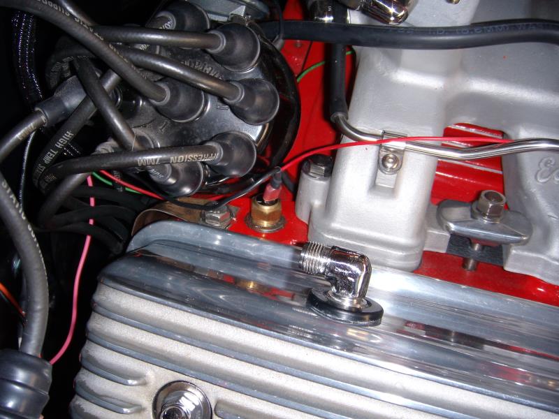

As for the thermostat I'm sure you will get a lot of different opinions. I use a 170°F Thermostat in addition to a 190° thermal switch to turn on my electric fan (if needed). I live in Southern California.

The plug for the bypass works like a charm - I wouldn't have believed it except for making a deliberate test. The bypass is a 5/8 (garden hose sized) pipe that connects the hottest water in the engine directly to the greatest suction of the water pump. Maximizes reheating the already hot water. There are those that recommend drilling some auxillary passage holes in the thermostat to prevent "dead heading" the pump when the bypass is closed up. My T-bird pump impeller is so inefficient, its hard to imagine how little pressure it can provide - so I don't think that is a problem for me. I have drilled three 3/16 holes in my thermostat which I believe encourages the warming water to flow right over the "pill" and get with the program of opening the t-stat.

Ditto with Greenbirds56 comments. I too prefer the 180 for the same reasons. My experience and observations have been exactly the same for about 20 years. Some flow tests were run years ago by the CTCI (Gil I think) that showed the same. Also, I believe the new Airtex impeller may be a lot more efficient. Many 'Stant" style thermostats appear to have substantially less area when fully open hence will be more restrictive. I too use the plug in the bypass and it really seems to help, especially noted a measurable difference on Sherwin Grade , US 395. The pusher fans on my Bird are set up similar to his, plus I run a thermostatic 5 blade clutch fan (originally from a Mopar) that fits the original shroud perfectly. Back to the shop....

Thanks everybody. I will add the brass ristrictor with the 3/16" orifice, however it I am still unclear on whether I need to add the bypass holes in the thermostat. Is there a picture of where these holes should be drilled? Also does anybody have a part number for a 180 degree Robertshaw thermostat (is this the NAPA item)? Thanks again.
