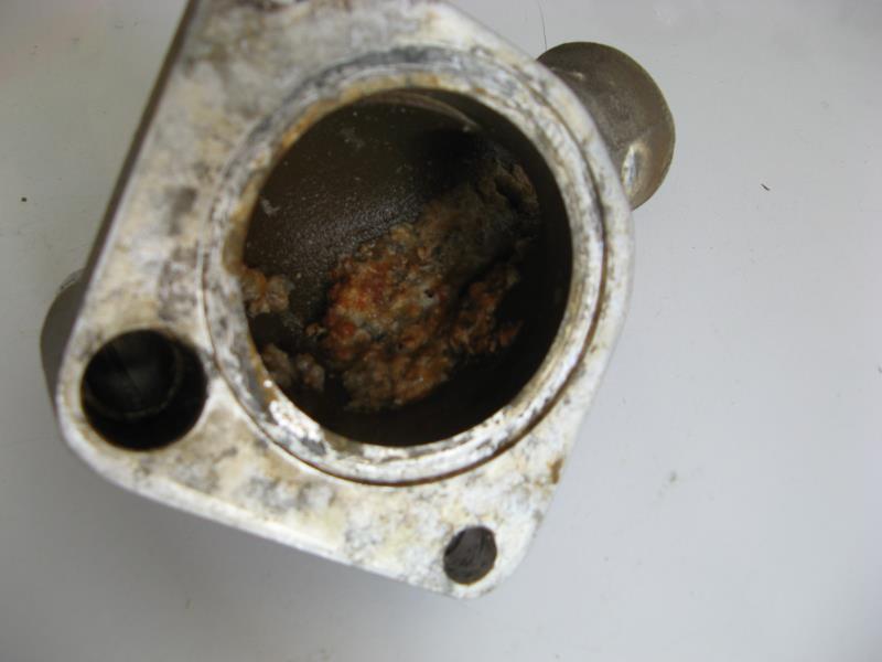

Took of my thermostat housing this afternoon to install new thermostat and I see this... I'm like WWHAAAT??? Looks like my Rebob housing has CANCER or something. Have know idea what it is, looks like calcium deposits but I run Demineralized water and a bottle of Water Wetter. Water pH was 7.2. It's just in the thermostat housing, nowhere else. Even the Edelbrock manifold is clear. Any ideas??
http://forums.y-blocksforever.com/Uploads/Images/6b469a1f-3ff6-4a19-bc65-e6d3.JPG
http://forums.y-blocksforever.com/Uploads/Images/d9d73790-de9c-4b72-8a18-8952.JPG

Was there any of that goop on the old thermostat?
By The Master Cylinder - 13 Years Ago
Hi Mark. No the Goop was just 'growing' on the aluminum thermstat housing.

Whatever that disease is - KEEP IT OVER THERE IN CALIFORNIA!!!w00t
Haha, I'll do my best to contain it. Should I call the HAZMAT team? Smooooth
By lyonroad - 13 Years Ago
I'll bet its the aluminum reacting with the cast iron. Mixed metals can do weird things.
That's what I was thinking, dissimilar metals + acidic water = electrolysis. That's why I checked the water pH which is/was neutral at 7.2. Does anyone here use an anode in their cooling system such as this; Radiator Anode? I need to invvestigate further.
Strange it occurred only in the aluminum thermostat housing only and not in the Aluminum intake manifold.
There might be dissimilarities in the aluminum alloys. But also the source of the goop may be elsewhere and only collects on the thermostat alloy. Do you have any zinc plated bolts threaded into the water jacket anywhere? I have a RV with a hot water tank that has a zinc sacrificial anode and after one camping season there is a lot of grey goop in the bottom of the tank. I also notice that anything made of pot metal (common in RV plumbing fixtures) eventually turn into stuff that looks like the goop in your thermostat housing.
No zinc or galvanized bolts, only stainless on the housing but they go into blind holes.
By pegleg - 13 Years Ago
Master, a thought, check the marine section of ebay or amazon for sacrificial elements for boat motors. Might check the water for salt too.
Master stainless and aluminum don't like each other but no problem if the threads are sealed. I wouldn't think that with blind holes it would be contributing to the goop you are producing.
Thanks Frank, that's a good idea.
Mark, I always use anti-sieze when using stainless steel bolts, Didn't see any signs of trouble around the bolts. And I was mistaken, the intake manifold bolts are stainless also and the front four holes (around the water passages) DO see water. Again no sign of problems there except one looks like it had water seepage past the threads. I'll have to be careful to seal those in the future.
Lastly, I need to apologize. Earlier in this thread I stated that my Mr. Gasket thermostat was made in Canada. I was looking at the package for the Stant Radiator Cap... Blush Blush The Mr. Gasket thermostat is indeed Hecho en China Blush Blush
