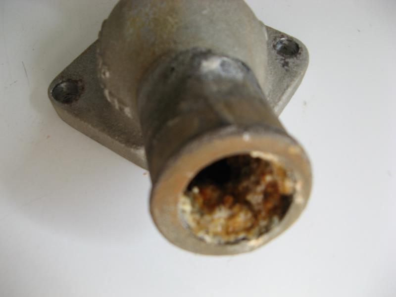

Took of my thermostat housing this afternoon to install new thermostat and I see this... I'm like WWHAAAT??? Looks like my Rebob housing has CANCER or something. Have know idea what it is, looks like calcium deposits but I run Demineralized water and a bottle of Water Wetter. Water pH was 7.2. It's just in the thermostat housing, nowhere else. Even the Edelbrock manifold is clear. Any ideas??
http://forums.y-blocksforever.com/Uploads/Images/6b469a1f-3ff6-4a19-bc65-e6d3.JPG
http://forums.y-blocksforever.com/Uploads/Images/d9d73790-de9c-4b72-8a18-8952.JPG

Was there any of that goop on the old thermostat?
