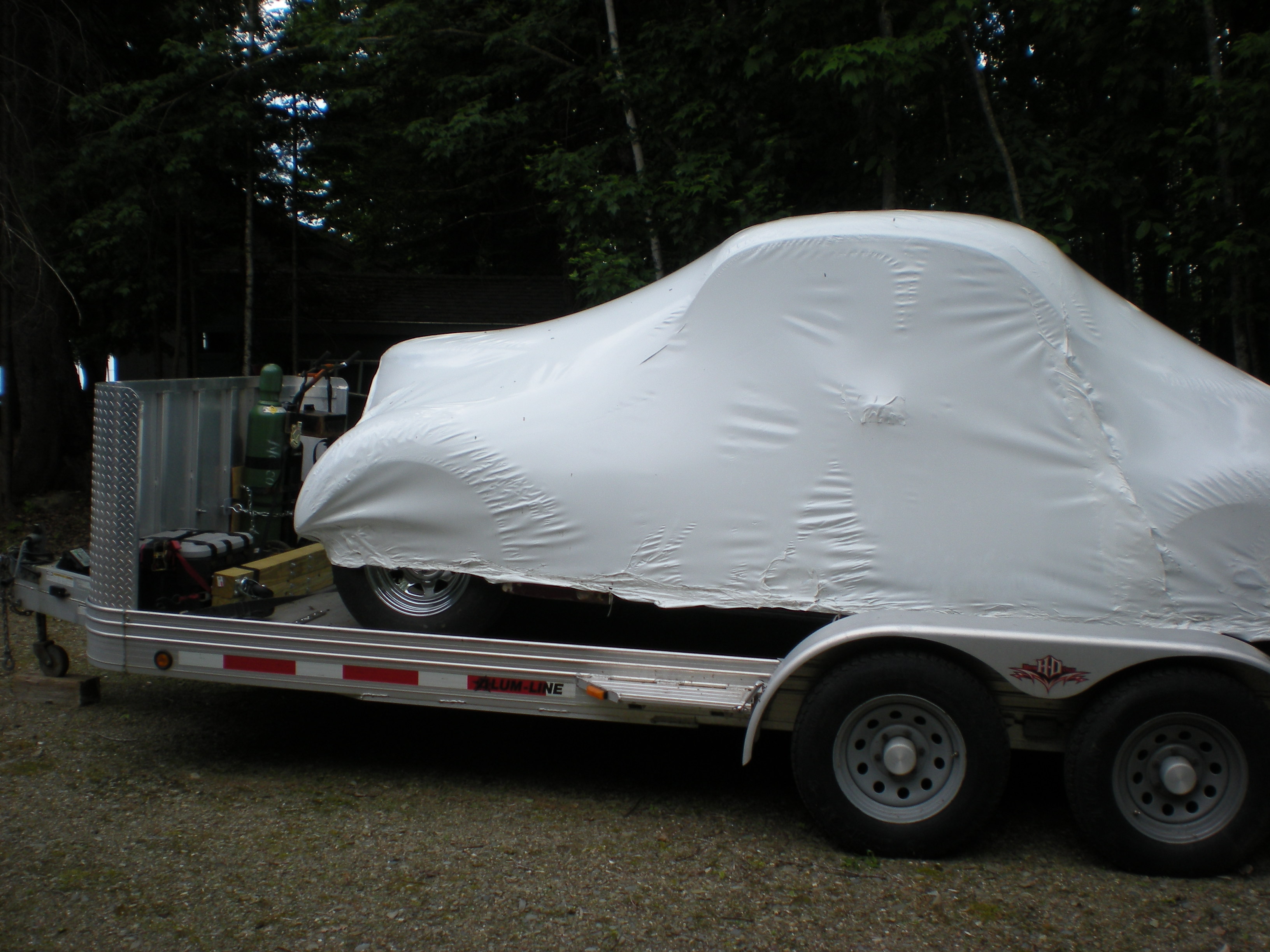

The time has come to head out. Need to disconnect everything tomorrow. Hopefully I'll be talking to you guys again "from the other side".
Rono
All Wraped-up 001.JPG (751 views, 1.00 MB)
