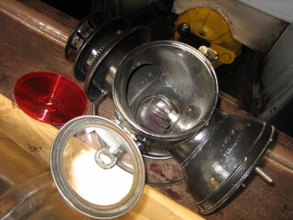

My old tail lights needed some work too,so to replace the rusted up scockets and add some new lenzs,I got a set of trailer lights from HF at $9.99,this gave me the parts needed for my update by gutting tialer lite and building some new brackets for sockets. The new lenzs give me a chance to used the bigger and briter side of these old lights vs smaller darker red glass lenz side I had used before,seems like a good idea with the extra cars on the road now to light up the back as much as I can. I put photo of my light work but it show only as atachmint below that you can cleck on to see,I haven't fig out why it didn't just show?I must of missed clicking on something.http://forums.y-blocksforever.com/Uploads/Images/43f2fca9-4cf6-4611-8d78-ec00.jpg
