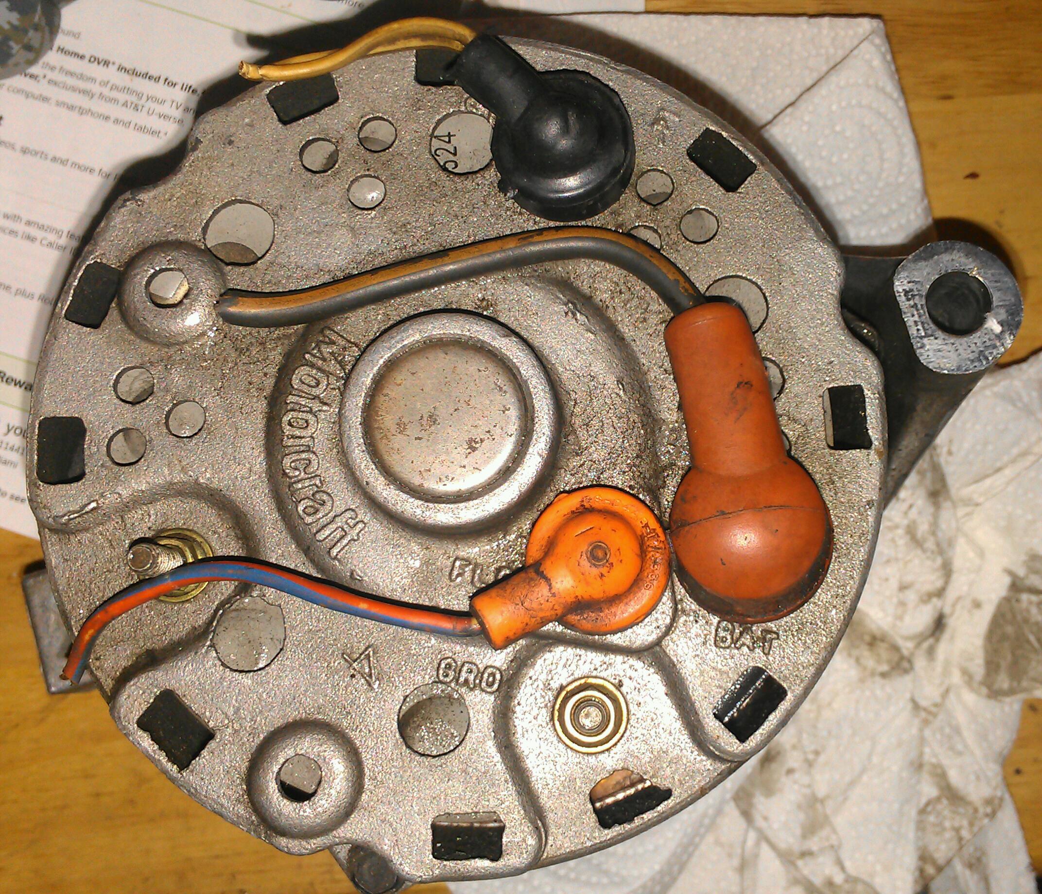

my photo didn't show ,I don't know why,but I guess its a link or something to it????of the Ford alt. that I have two of,would like to figout a way to use one with out pending more then $ 30 if it can be done?Its been a trip to the passed as I remeber some things I forgot after trying to do it again,ton of fun! These no fiberglass now or then,but have some glazzing puddy to smooth out some rust pits that seem a lot deeper now. Next thing to find or make some how is alternator working and some glass for windsheild. The hotrod piggy bank is really getting low,so my plan 4 a new one wire Alt. is out,I'll need to fig a way of using stock Ford Alt. I have and find a Ford reg for it. Along with other little stuff on my list,getting closer to a good old time ride around!.
