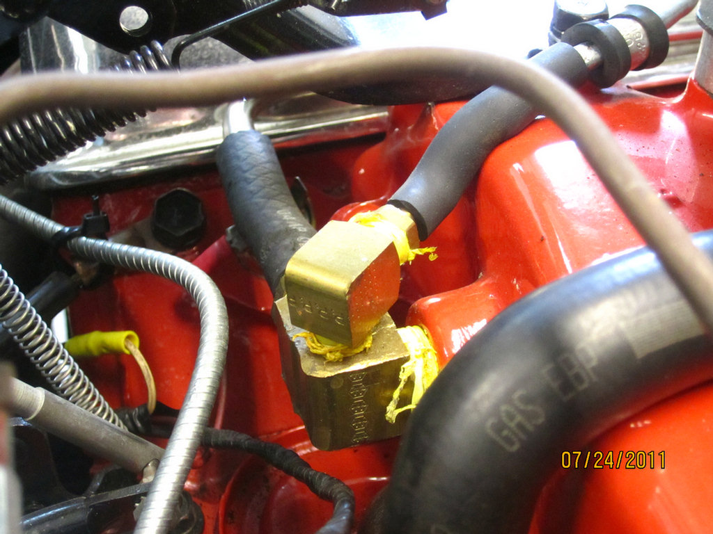

Three strikes on the 78 Zephyr-Fairmont PCV valve. Went to three different stores and none of them had one.
I did disconnect the vacuum line from the manifold to the fuel pump and looped it back to the other vacuum line to the fuel pump. Then put in a straight fitting in the manifold to accept the vacuum gauge.
Hose/line to fuel pump.
Left hose to power brake, Center hose to fuel pump, Right hose is PCV.
Straight fitting for vacuum gauge. Vacuum lines to fuel pump looped together.
Engine warm, vacuum to carb plugged, brought initial advance down to 10 degrees. Idle speed in neutral = 700
vacuum gauge reads:
700 RPM seems to be as low as I can get the idle.

This chart isn't as cool as some that are animated - but it will show you the information available from the vacuum gauge.
http://www.classictruckshop.com/clubs/earlyburbs/projects/vac/uum.htm
The tube you have disconnected from the fuel pump - direct from the back of the intake manifold - is as good a tap as you will find. Do you have a thermal break isolator under the carb? Drilling a passage - and adding a short piece of brake line tubing with JB weld or epoxy can add an additional manifold vacuum port. They work best when they sample both chambers of the split intake manifold.

You will want to record reading at idle with motor fully warmed up.Gauge should read 19-21 and steady in a motor in good condition.If its not steady how much does it vary?Whatever variance you note is helpful in diagnosing possible problem.

I have a vacuum gauge. I note that this carburetor does not have a vacuum tube coming out of its base like the last one did. However, there is a block near the back of the manifold that I can adapt some fitting to allow the gauge to be connected there. What kind of readings would you suggest I record when I return home on Friday?
