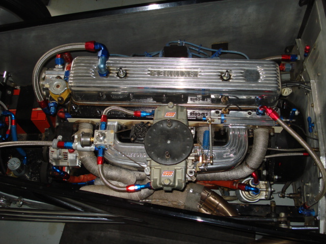

New valve covers with Offy breathers.

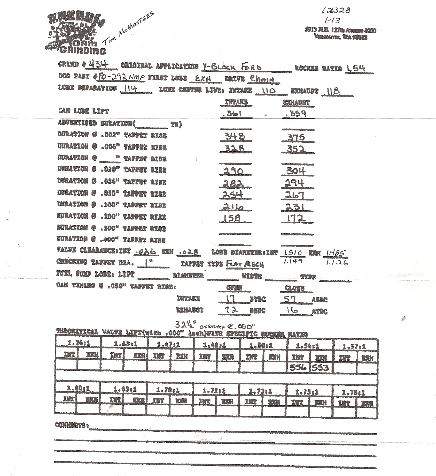

Charlie, this must be a streetable engine you are running.. those peak numbers for HP and Torque are not that high up in the RPM band it looks like to me. What kind of cam specs do you have (if you want to share)?

Daniel, you have it quite right.  Turbo cams are quite mild compared to naturally aspirated race cams.  The lift is still important, but the overlap is decreased substantially.  The lobe separation on the Brick engine was 108* while the turbo separation is at 114*.  Ramp speeds and other cam lingo is a little above my head, but reducing the overlap starts exhaust scavenge earlier and helps keep the charge in the combustion chamber on the intake stroke.  The attachment below is the cam card which shows all the specs.
