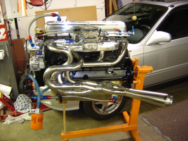

How about some photos of the Jimmy. I really liked them. Had a buddy with a 50's Sprint car that ran one. When he gave up on it and went to a SBC we bought the motor and stuck it in a 52 Chev Convert. THAT was a fun ride. I learned a lot about replacing bearings with that motor. Probably trying to rev it too high. 302 with a 270 head and a McGurk 5 carb intake!

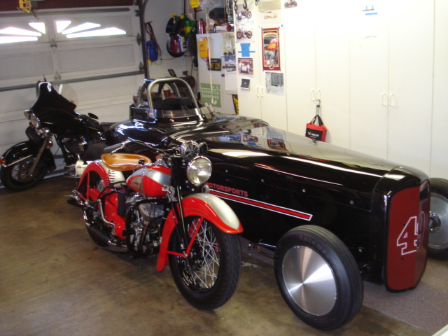

I hope these come out. An older picture before it went in the roadster, one in the car and my 2 car garage.  The '56 Vic is now in there too.
roadster water system 005.jpg (520 views, 145.00 KB)
Jan 22, 2007 004.jpg (474 views, 143.00 KB)
My Garage 006.jpg (525 views, 143.00 KB)

Neat stuff!  liked all the pix!  any at speed? BigGrin
