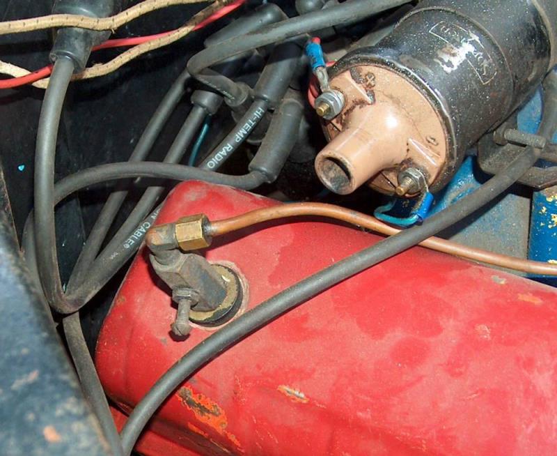

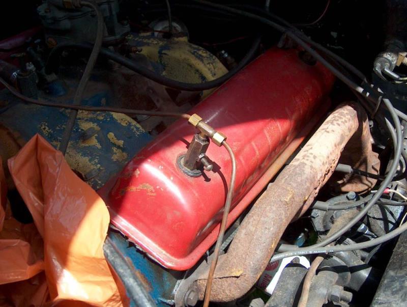

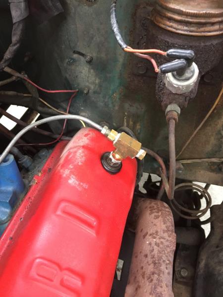

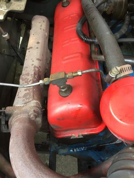

Posts: 2.0K, Visits: 306.6K
http://forums.y-blocksforever.com/uploads/images/f4924df3-9d89-4e25-9589-e0b7.jpg
http://forums.y-blocksforever.com/uploads/images/46838a5d-840f-4465-94f0-4f6d.jpg
http://forums.y-blocksforever.com/uploads/images/c092ebdf-d68e-49d4-b2aa-21ef.jpg
http://forums.y-blocksforever.com/uploads/images/a8a19d0d-89d6-4ee9-b936-65df.jpg

Very old school; I don't think anyone is installing those external lines today.
Kultulz addressed pretty much all of the causes and fixes for oiling issues. If, by chance, you have a cross-drilled camshaft instead of the more common with an oiling groove, there should be no need for concern.

Kultulz’s pictures are perfect examples of two different engines with the added overhead oilers.  If that top end issue was as prevalent as the link to the video would lead you to believe, pictures of those overhead oilers would have been readily available to insert within that video.  While not knowing the exact number of the millions of those Y engines that were manufactured over the years, the percentage requiring overhead oilers was extremely low and most of those were attributed to poor maintenance and service intervals and not necessarily to a design issue.  Undoubtedly that percentage is significantly lower than the 4% defect rate that GM is currently comfortable with having during the last five years of crankshaft issues in the LS engines which truly is a manufacturing/design issue.
I do still get the random core FYB engine that has overhead oilers installed on it.  I find that a majority of those added oil lines are only on one side of the engine and not both.  Delving deeper into these engines (which have been previously rebuilt), I find the center cam bearing incorrectly installed with only two of the three bearing holes being properly aligned in the block.  Depending upon the clocking of the bearing, one of the upper oil holes in the center cam hole is not aligned with the appropriate hole in the bearing which makes it a 50/50 chance on which bank is getting or not getting its required oil.
