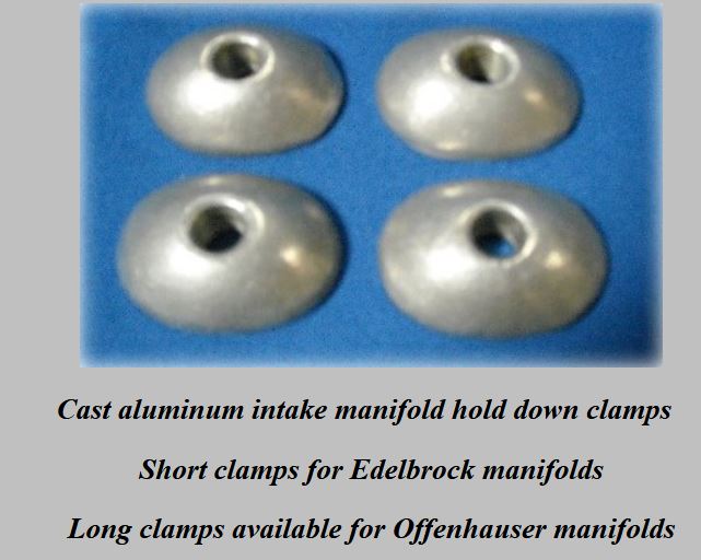

http://forums.y-blocksforever.com/uploads/images/9d5a22ef-13f3-4a23-831a-3030.jpg
