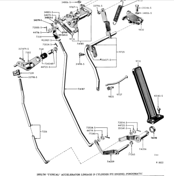

1956 Ford Accelerator Linkage

The rod that goes from the accelerator pedal to the linkage inside the engine compartment is always bending and does not push straight. I know there is a rubber grommet to keep it centered. In order to get the grommet in the hole I had to slice it. Is there a method to stabalize this rod. Now, I have to chase it around with the pedal/ Thanks.

Is the rod bent/damaged or is the pedal itself damaged?

If the rod is inserted into the pedal and it still moves around, them the problem is another part of the linkage .  Check to make sure everything is tight.  Have someone work the pedal while you watch the linkage in the engine compartment to see where the problem is.. Problem could be a bad engine mount.
Another possibility if the rod itself is bending.  Your linkage could be too tight  or a spring too strong which s causing the rod to bend.  Never seen the rod bend on either of my cars.

http://forums.y-blocksforever.com/uploads/images/763cb379-e3fe-43e8-8069-b17f.png

I don't know if this has been mentioned in either of your posts,  but There is a procedure to adjust the linkage which may help in both situations.  The Shop manual has this procedure.  Or there is a manual on just transmissions  which is available.
Skyliner57 (4/12/2026)
Has anyone had an expeience where they adjusted the linkage to prevent this?  Maybe adjust the U Bolt?
