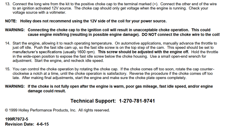

I notice the data sheet included with elect. choke Holley carbs. specifies 12V as a mandatory minimum. Just curious if you have experimented with supplying one with 6V only (?). Would the choke possibly thus still fully open, though more slowly? Or, would I need a transformer for sure?

Daniel....all of my cars are still 6 volt positive ground.  One of them has a more "modern" Holley 4 bbl carburetor with an electric choke obviously designed to run on 12 volts.  I too, doubted that the electric choke would work on 6 volts but it does open which surprised me so I have left it alone.
