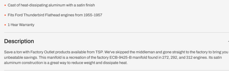

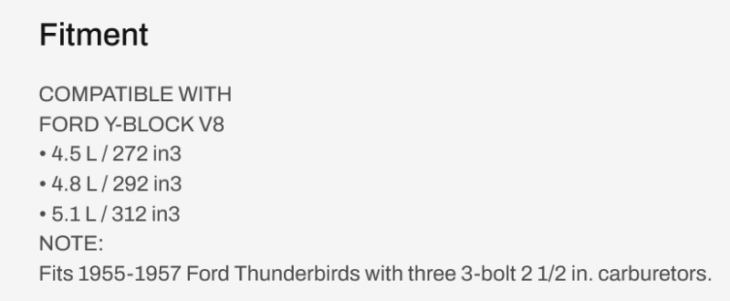

A perfect match for the CHI-CON SLOPPY COPY GM HEI DIST and SUMMIT CARB installs --
http://forums.y-blocksforever.com/uploads/images/6325eea3-e7ed-4036-87cc-da12.png
http://forums.y-blocksforever.com/uploads/images/c2a54e55-c30b-4935-88a2-450b.png

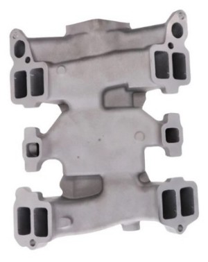

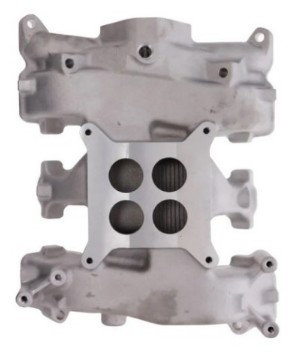

Based on the three ‘locating’ or machining tabs on the bottom of the pictured intake manifold, it does appear to be the manifold that's being made by Mercury 8 Restorations in Australia. That casting is based off of the ECZ-B intake manifolds and dyno testing has shown that the performance of that particular manifold also matches the factory iron ECZ-B manifolds.  Dyno testing has found it to be a suitable replacement for the factory manifolds.  Four barrel intake manifolds are scarce in Australia so that manifold would have a strong market over there.
http://forums.y-blocksforever.com/uploads/images/1a235b8a-faf6-4fe7-acc8-1f20.jpg  http://forums.y-blocksforever.com/uploads/images/263d086c-bd7c-43d6-b589-ecf9.jpg

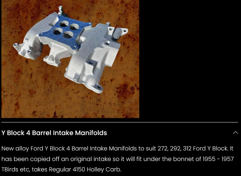

https://www.mercury8restorations.com.au/
http://forums.y-blocksforever.com/uploads/images/aeb12341-471e-43fc-bd69-bbe4.png
If they are bringing this in from AU their paying freight, duties and tariffs, that is one heck of a deal depending on COUNTRY of ORIGIN (casting - machining) and flow testing ...hint ...hint.
