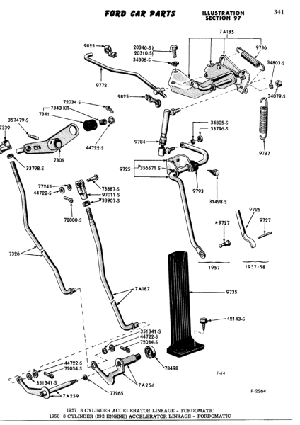

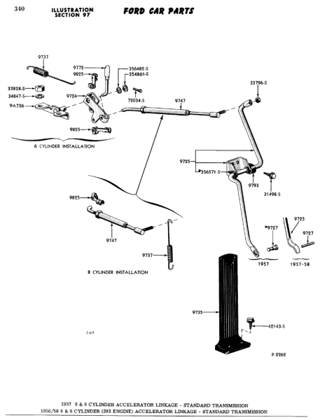

When you say 'BELLCRANK' ...
1957 FORD RHT 312 - STD or AT?
http://forums.y-blocksforever.com/uploads/images/d6dd8ff5-e753-4009-bcfc-f2e2.png
PN 9725 or 7A185?

AT thanks for reply

After talking with Harold on the phone, he clarified that what he needs is the auto trans kickdown linkage that bolts to the intake manifold. and not necessarily the accelerator linkage (aka bell crank).
