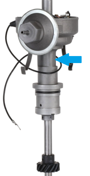

Kultulz, I used a Y-block distributor I picked up at Napa several years ago back when they still had stock of the cardone rebuilds. It's the one that has the flat sides below the top piece.

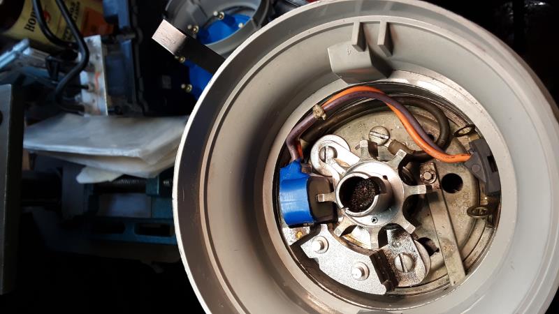

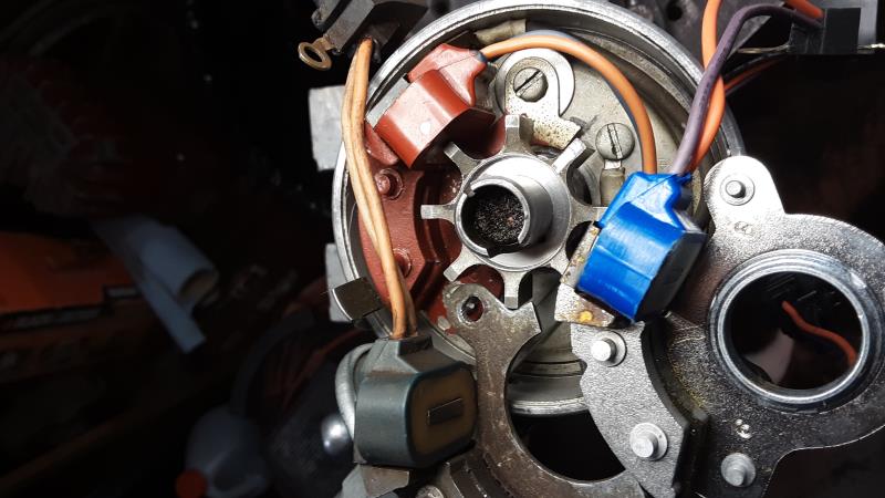

I had to chose the difficult route for a Duraspark system because I'm running a mechanical tach in my truck. The distributor is a typical '57 tach drive distributor which lent itself well for this because of the ball bearing breaker plate. Not only did the ball bearing plate provide ample realestate for the pole piece but it also moves the "pickup" coil in a true arc thus maintaining a constant air gap between the coil and reluctor.  It wasn't necessary to make any serious modifications to the tach drive distributor so points and condenser could be put back in if desired. I'll try posting a couple pictures I found showing how the pickup coil was modified.http://forums.y-blocksforever.com/uploads/images/38681f29-86ac-479e-8154-99b6.jpg

Here is the final assembly performing flawlessly for many years.http://forums.y-blocksforever.com/uploads/images/fece1ad8-8811-473a-a9d5-51b4.jpg
