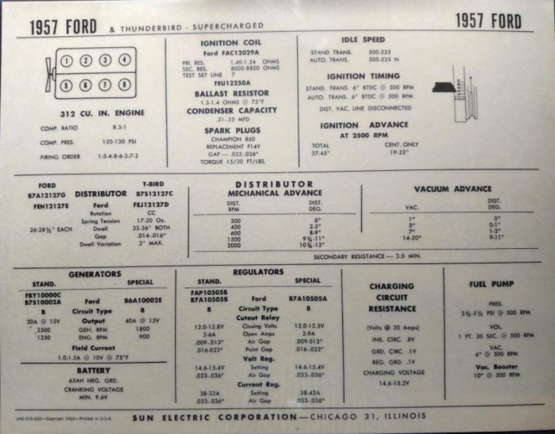

Interesting that the F-code/dual point condenser part # is different from the E-code one.  I found a wide range of electrical values from a grab bag of NOS condensers, all seemingly identical, so the specific value spec. would likely be more relevant than any part # (?). Maybe the dual point outboard mounting is the issue (?).

If I remember correctly, the difference in condensers is the length of the lead wire.

I would think the rating is higher as it has to absorb more as a result of the longer dwell time and coil saturation.
My WSM's are buried or otherwise I would find out.
http://forums.y-blocksforever.com/uploads/images/4c02c9af-0fe3-42ba-9083-0635.png
