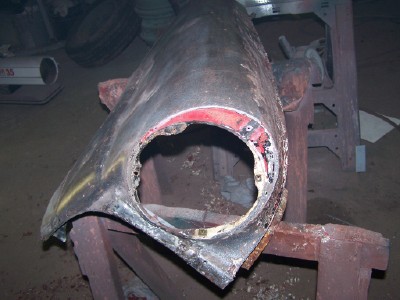

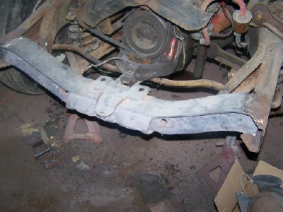

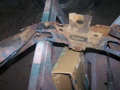

well after attending the c-bus race i have been working hard on getting this beast going these are some older pics but i will get some up to date ones loaded soon

ew frnt crossmember installed.jpg (340 views, 165.00 KB)
old frnt crossmember.jpg (313 views, 147.00 KB)
front fender.jpg (328 views, 144.00 KB)

Wondering if you drilled holes in the lower corner of the cross member? The new repo's have a drain hole Ford forgot to put them in.  Gerry

Hi Mr y block don, Im doing a body off on a 54 mercury monterrey 2 dr ht. I need to get the front crossmember from this place in okla. How did you weld yours in? Mig, Tig, Buzz box? How did you remove it? Did you cut off the angled front frame horn? Thanks  a lot.54 Merc Mike

we cut it with a torch slowly then after it was out i took a grinder (small one) and gound off what was left then slid the new one in to where the old one was and took several measurments from side to side and front to back to make shure it was square in the frame then we just migged it in BigGrin
