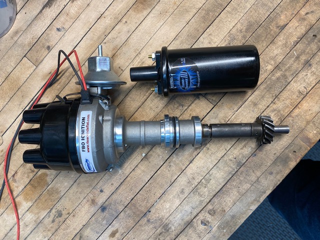

Just reading thru old threads ...
SUPPOSED FBO IGN CONV  -  DUAL ADVANCE WITHIN ORIGINAL LOM SMALL BOWL DIST
http://forums.y-blocksforever.com/uploads/images/3d45f743-64ef-4bb9-98cb-23ca.jpg
I just noticed. That appears to be a SBF DIST ...
This explains all of the trouble. I was wondering how actually doing it would be possible.

I agree in that is is a SBF distributor which has the same lower end machined as our Y-block distributors. What they did is cut the shaft, used a properly (hopefully) machined sleeve to position the lower shaft section with hex drive to the PROPER length. Then it's just a matter of installing the gear in the proper place per the Y-block shop manual. In this case, the gear should be the larger 15 tooth  Lincoln gear.  I have done somewhat similar Lincoln to Ford Y-block swaps.

FORD DEARBORN POSTED -
"I agree in that is is a SBF distributor which has the same lower end machined as our Y-block distributors. What they did is cut the shaft, used a properly (hopefully) machined sleeve to position the lower shaft section with hex drive to the PROPER length. Then it's just a matter of installing the gear in the proper place per the Y-block shop manual. In this case, the gear should be the larger 15 tooth  Lincoln gear.  I have done somewhat similar Lincoln to Ford Y-block swaps."
I hope you can allow for my ignorance. I have read and re-read this thread a dozen times.
The OP posted that FBO stated they would take his take-out LYB LOM DIST and convert it internally to a DUAL ADVANCE DIST (and if using FORD DUAL ADVANCE internals, how could one make the internals fit within the smaller LOM DIST bowl?).
The returned DIST PHOTO the OP posted was a SBF DIST, and it gave the same problem(s) as the CARDONE REMANS of a few years ago.
And if FBO did substitute a SBF DUAL ADVANCE DIST what happened to the LYB LOM sent in for modification?
Am I having dementia attacks or does the above make any sense?

Ha! KT you are very observant, correct and are not having dementia attacks.  FBO did not install dual advance distributor guts in a LOM distributor. That would be  a next to if not impossible task due  to bowl size/depth etc. etc..  What happened to the original LOM distributor? They must have kept it. FBO obviously was not on top of their game, in this instance. They had the original LOM distributor to use as a pattern to build the new modified distributor.   It appears the distributor you captured from this thread and recently posted is an aftermarket copy of/for the SBF adapted to fit Y-blocks. It's unfortunate this seems to cause so much confusion.

I seem to remember some time back reading where they (FBO) could re-do a LOM to DUAL ADVANCE. Possibly they designed their own internals to fit within the LOM bowl? But is was a switcher-roo.

That would make sense to me anyways, because the collar, lower shaft with gear from the original distributor would be coupled to the shortened/shorter SBF shaft. Hopefully after all the issues with Martyk98 they got the dimensions right.
