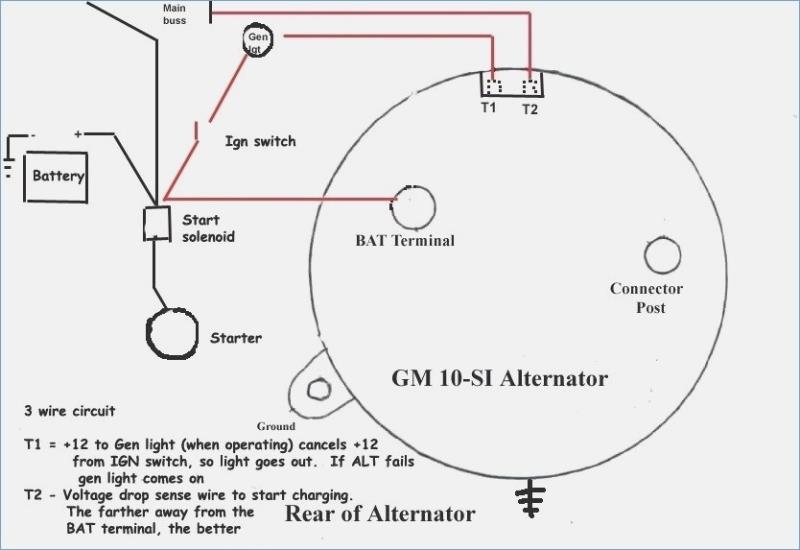

I put in an aftermarket wire harness (it had already been converted to 12V) and I didn't hook up the idiot lights for the generator and oil pressure (used gauges instead) and now I would like to use the lights.  It has a 3 wire GM alternator.  Can some one provide a wiring schematic to do this?  For both the oil pressure and alternator?
Posts: 1.9K, Visits: 194.9K
This one should work for most Delco 3 wires. Don’t worry about the main feed going to the starter solenoid, it can go to the battery.
The third wire to the main buss is the “voltage sensor wire”, or whatever it’s really called. It ensures full charging voltage goes to the battery. Sometimes needed, sometimes not, but helpful iff the battery is a ways off in the trunk. It also energizes the alternator. I’ve had some that wouldn’t charge till they saw 2500 or so rpm without it. Once charging they were fine, they self energized. For the oil pressure, just use a tee where you’ve got the gauge hooked up, or (if they’ll come out) pick one of the gallery plugs up the drivers side of the block. Y blocks are side oilers, but we never call them that.

Thanks, it appears very simple, but I have a 3 wire GM alternator which has no external regulator.  The schematic above, I hope, solves the problem.  The problem I have now is a schematic for the oil pressure light
