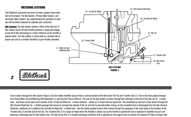

A 200f temperature is nothing to worry about IF it stabilizes there.  Does it continue to climb after 200 or does it stay at 200?  Your engine is not overheating until coolant is boiling out.  If that is not happening, then it doesn't matter what temperature it is as long as it is stable.
If the stall only occurs at idle, my guess is that your idle mixture is far too rich.  It fowls the plugs at idle but when it is above idle, the mixture is better and cleans the plugs.  If you don't already have the manual for your carburetor, download it from Edelbrock's site.  Read and understand everything about the carb theory and function so you know how to tune it.
As far as your eratic idle speed, make sure all throttle return springs are in good condition and not broken or worn out.  Make sure your throttle linkage is lubricated and operating smoothly.  Make sure that the throttle plates were not binding on the smaller holes in the manifold manifold and that they are not binding on your spacer.  Also make sure that your mechanical and vacuum advance are operating correctly.  Everything else the same, rpm will increase with more timing and decrease with less so if advance weights are sticking or the vacuum advance  is sticking, it can cause your idle to change.

Hi, i have checked the vacuum on idle 600rpm av its about 16 when i measure it on the big middle connection on the front of the carb, i have my distributor connected on the left side on the carb and there is no vacuum there on idle is correct? this is the number on my distributor C3AF-12127-U i have checked so it moves and returns good with vacuum. about the temp i have an electrical fan that starts at about 200f so it wont go much higher than that. i had the carb taken apart a few weeks ago and cleaned and new gaskets, i have tried to set up idle screws but they currently sits at 2 turns out at both sides. When setting the ignition the vacuum should be plugged to the distributor, right ? i will check the linkage one more time to make sure its not getting stuck.
I read somewhere that a 600cfm carb is to big for an 312? dont go over 500cfm with stock engine they said, some of them had problem tuning the 600cfm carb but solved the problem with the smaller carb. is this true?
update i have now tried to adjust the idle screws to maximum vacuum bat cant get it higher then 16 and it goes up and down between 15-16 all the time

i dont know the condition of the engine the rocker arms looked okay i think. but about the carb is it possible that the engine gets to much fuel and gets flooded with gasoline and therefor dies? because if i let the engine stall its realy hard to get started again. and if i drive away when its about to stall the sparkplugs dry up and works properly again? just a thought i have. and this might be caused from a to big carb. but i will try to get the cranking compression test done tomorrow. and i have no idea on the milage

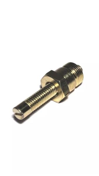

Re the idle screws, one test you can do while it is idling well is to screw one all the way in.  The engine should stop running when you do that.  If it does not, then fuel is getting into the engine some other way, resulting in a richer than necessary idle mixture.  Another thing to check for a rich idle mixture is to let it idle until it stops and then pull a couple spark plugs to see if they are gas fouled..
