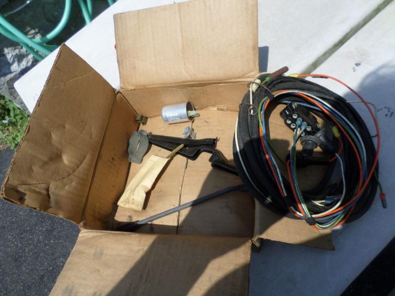

The Shop Manual shows two different  Wiring Instructions Diagrams. Must be pretty rare not to have any at all? Wonder what Year Turn Signals were Mandatory? There is a NOS Dealer installation Turn Signal Kit on Ebay. Shows all the Contents. Item # 273214818745

The above post describes CFR (CODE of FEDERAL REGULATIONS-
Turn signals were mandated by government 1/1/1955 by an INTERSTATE COMPACT making their install mandatory.
This would explain early 1956 MODEL YEAR install as being optional on all or low trim levels and the availability of OEM kits to install-add on to early 1956 models.
http://forums.y-blocksforever.com/uploads/images/efce7fab-78c9-487c-8b2b-fb41.jpg
