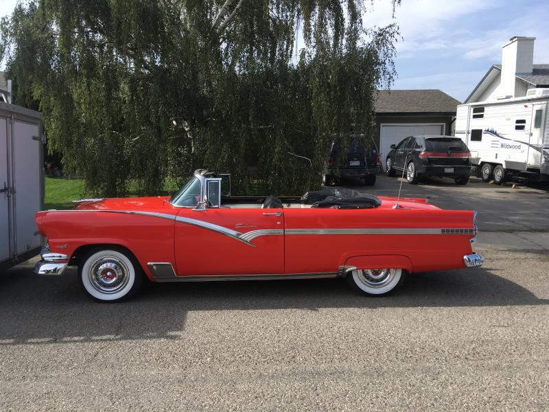

Thanks Steve. I am going to install Pertronix. The advance Unit looks like its pretty flexible as far as Rate of Advance and how much Advance. Just happy to have found a proper Distributor so I can get on with my Holley Upgrade on my latest Purchase.http://forums.y-blocksforever.com/uploads/images/dce4587d-532c-4a7b-8aa3-1a2b.jpgse.
