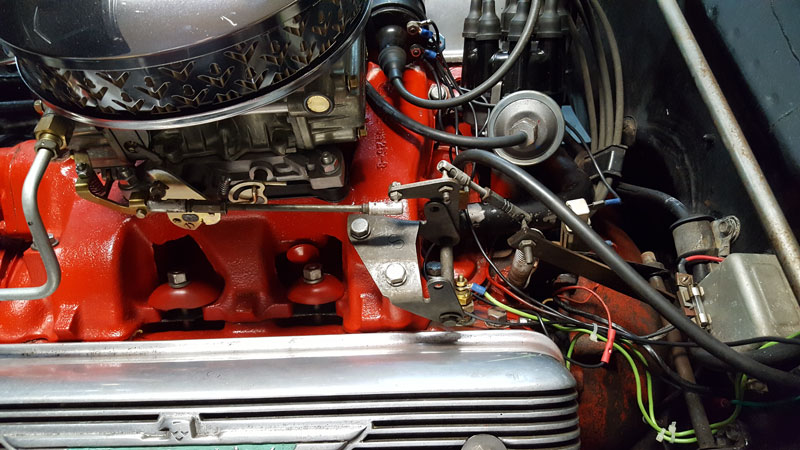

                I don't know if this will help you or not.  Here is a photo of the throttle linkage in my 1955 TBird w. OD.  The car came with a Teapot.  It's been swapped for a Holley.  The linkage is stock.
                Posts: 3,
                Visits: 496
                What you are showing is linkage I don’t have. Very curious. Thank you. It looks like the same bracket used for automatics without the step down linkage.
