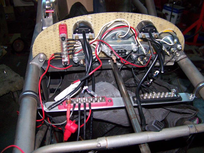

More wiring done http://forums.y-blocksforever.com/uploads/images/0c648f01-8215-4441-acb7-133e.jpg
