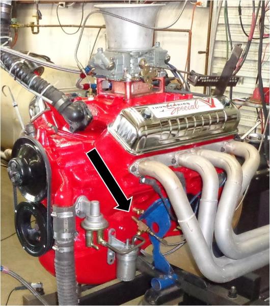

On the dyno, I typically use the oil galley plug that aligns with the #2 main for the oil pressure and oil temperature hookup.  That location is used simply due to it clearing some of the other dyno hook ups.  Any of those ¼”NPT plugs on the oil filter side of the block would be a suitable location to get an oil pressure reading.
http://forums.y-blocksforever.com/uploads/images/cc78d85d-f54a-44ef-b1b7-3083.jpg
