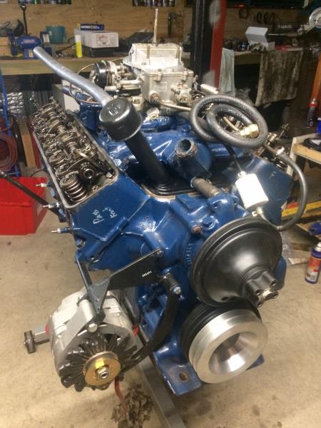

If you caught my earlier post about the water leak- you may already know that I have finished the run-in process and finally have the timing pretty well dialed in.
I am getting a constant 15-16 on the vacuum gauge with the stock air cleaner off. As soon as I put the stock air cleaner (oil bath type) back on, the vacuum dropped down to between 5-10. I'm planning on converting the old air cleaner to a modern filter and cut a few extra breather holes. Anyone have a similar experience? do you think this will help the problem?

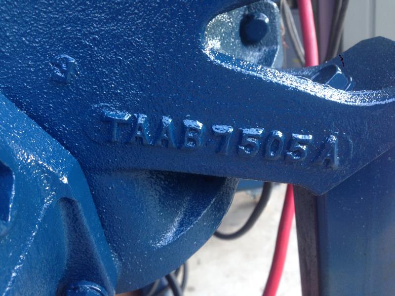

The heads are mismatching at the moment. I'm trying to track down another matching head. I have 1 big letter ECZ-G and 1 COAE.
