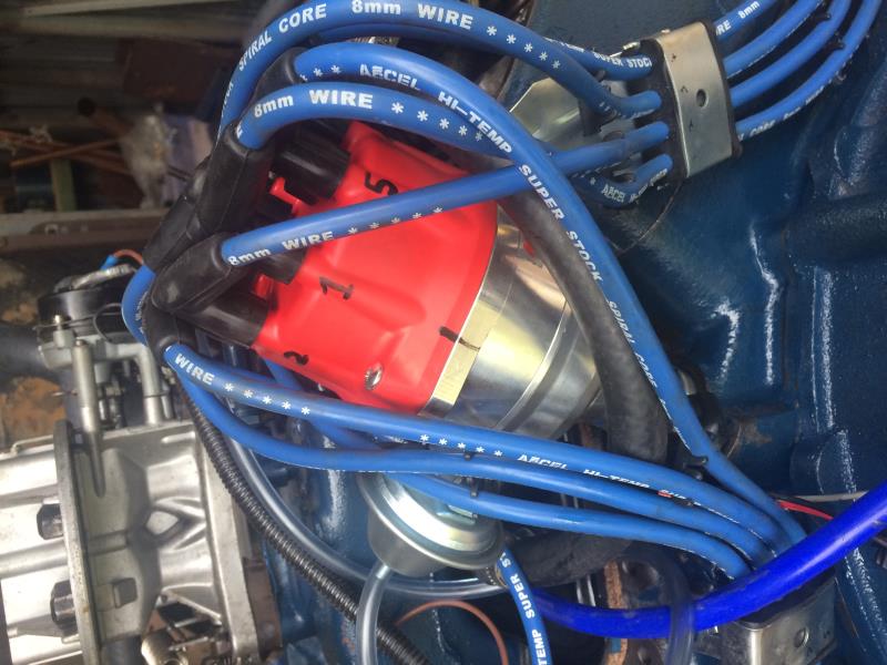

I re-checked #1TDC and made sure the rotor was at #1. I ran back through the firing order cranking the engine by hand and checked the valve lash- all good.
I'll do a quick compression test too.
View of dizzy from pass side

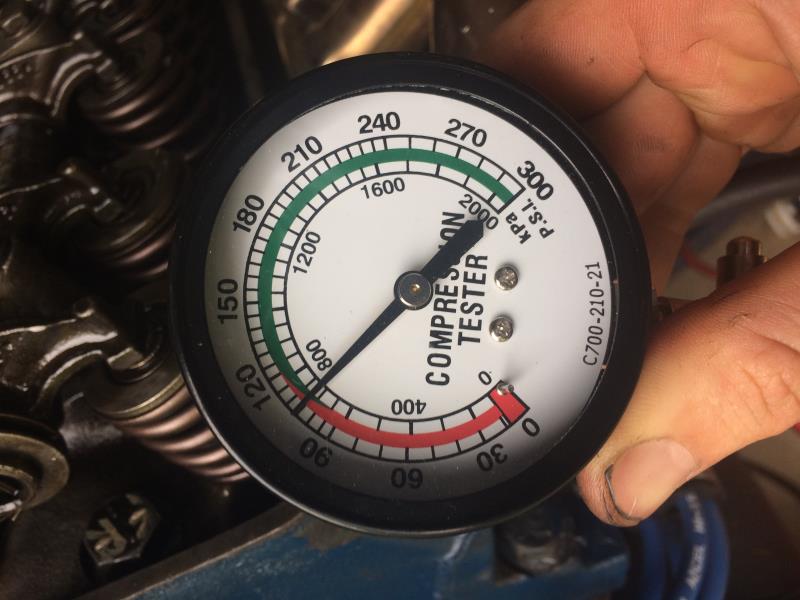

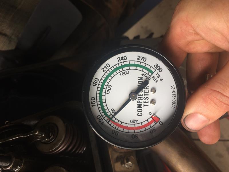

Just checked #1 and #4 for compression and got this reading. This reading was after 3 compressions, I went for 4 but it didn't change.
#1
#4

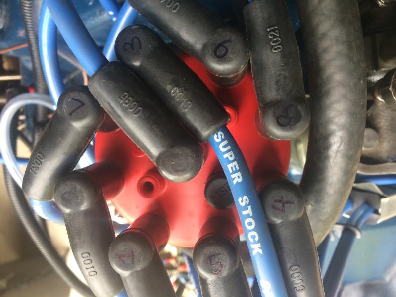

Thanks for the picture of the bell housing, it just didn't look like a stock on in the earlier picture, probably my old eyes.
Looks like the firing order is correct. Compression is a little low, but on a new engine I wouldn't worry to much it will take a while for the rings to seat but it should be enough to fire it. Did you have the carb wide open when you took the test?
