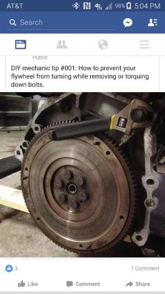

If on an engine stand, use a big screw driver to wedge into the teeth of the flywheel and lock it in place or thread in 2 flywheel bolts and use a long wrench to hold the crank from turning or get a proper flywheel turning tool to hold the flywheel in place.
Posts: 1.8K, Visits: 190.6K
I stole this off the HAMB. I'm not this clever
