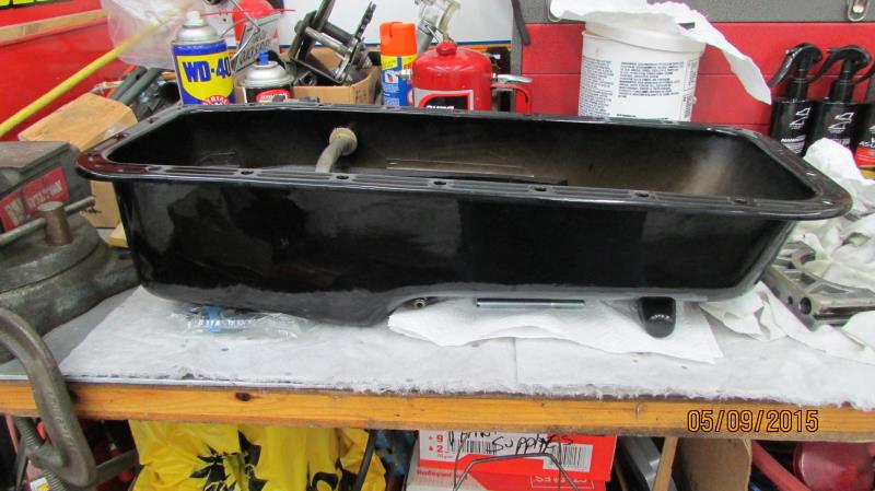

identify this oil pan

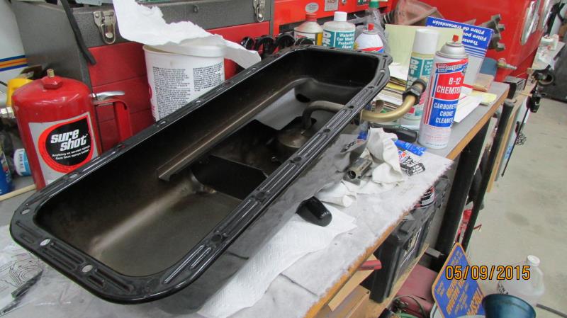

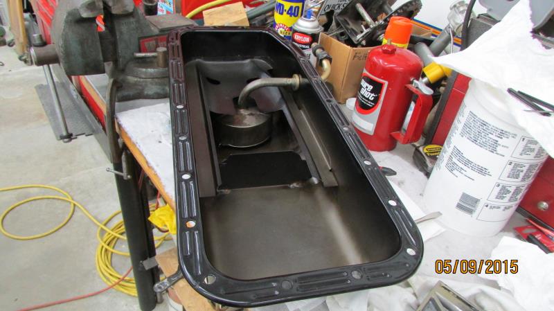

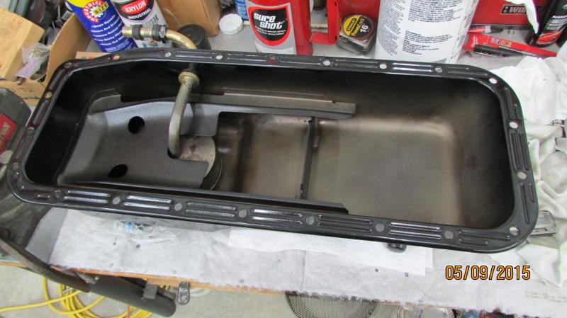

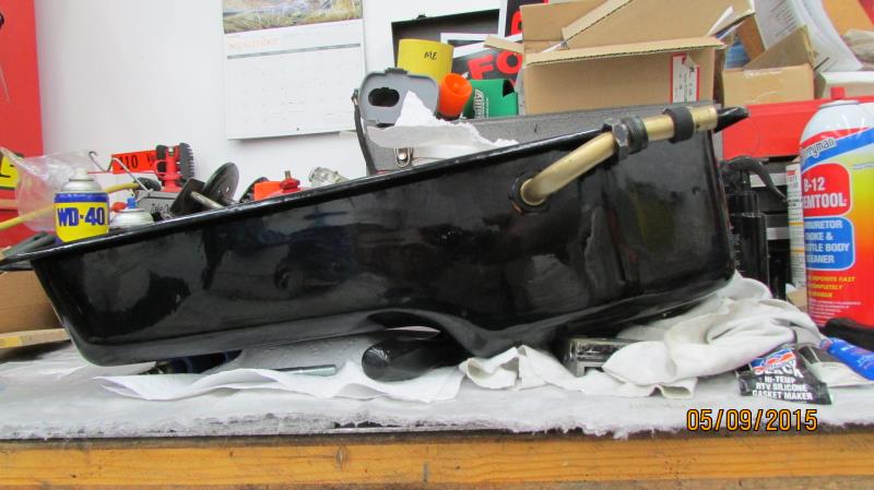

http://forums.y-blocksforever.com/uploads/images/50026a32-1530-450e-bbf2-f887.jpghttp://forums.y-blocksforever.com/uploads/images/42fcc239-5ea4-4ad8-b8c1-1925.jpghttp://forums.y-blocksforever.com/uploads/images/585784d0-6f99-4a60-ba84-08c3.jpghttp://forums.y-blocksforever.com/uploads/images/72afa906-3130-455b-9e3b-db5e.jpgI am going to try and post some pictures of the oil pan on my 30 coupe. I hope some one can tell me the original application, as I would like to find another like it. I know that the one baffle in it was added by someone and is not stock, or at least it looks like it was added.  any help would be appreciated. I have other rear sump pans, but they all have a  "double step " where this one is a single step.  thanks, -----Jimhttp://forums.y-blocksforever.com/uploads/images/bb365d97-cf9b-403d-9926-a693.jpg

Hmmmmm...  As you say, a baffle has been added.  I believe that it is Ford '55-'57 T-Bird only y-block rear sump oil pan.  Smile

Well, the pickup truck pan on my 32 has a small second step. And while that looks like a bird pan, I think it's too deep in front. The birds still in off site winter storage so I can't be sure. Didn't they make some heavier truck pans that held more oil, for like a 1.5 ton or up? Or stationary engines. I don't know what the marine pan looked like, but that's another possibility.
carl
Posts: 1.2K, Visits: 20.6K
It looks like the heavy duty truck pan I have,but hard to tell without getting a measurement on the sump depth  Carl

The pan is for 55/57 T-Bird.  Rear sump, rear angled drain plug---T-Bird.  Can be used on other engines.
AH!  I'm wrong!  Miker and Carl know better.  Miker's right.  -It's too deep on the front end to be a 'Bird pan.  Me thinks the HotRod Reverend had one just like this for sale a hundred years ago or so.  IF I'm right, they hold more oil (an extra quart?) than the 'Bird, passenger car, and standard rear sump truck oil pan.

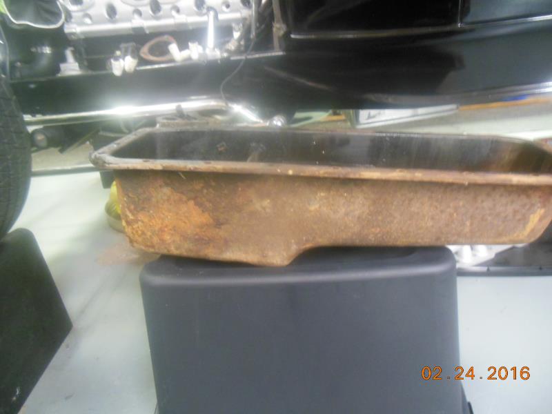

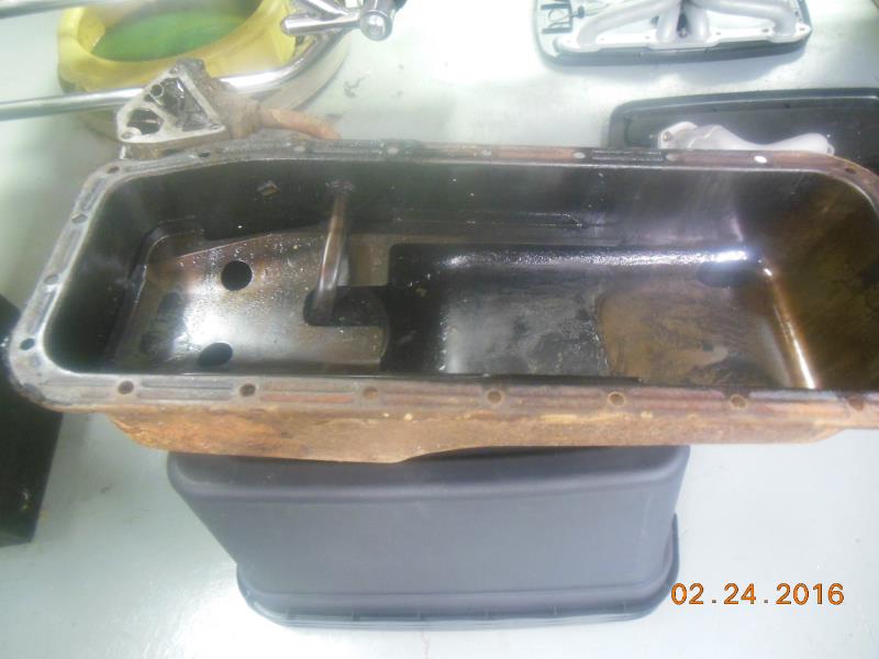

I just disassembled a 1963 super-duty that has a pan like that . I will try to upload pictures. It measures 6" deep. http://forums.y-blocksforever.com/uploads/images/95b98a42-41a6-4922-b1aa-0214.jpg

sorry about previous picture..http://forums.y-blocksforever.com/uploads/images/f94d9d02-79c3-4eb3-b21b-85bc.jpg
