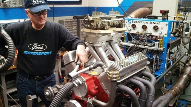

This is from the fertile mind of Jerry Christenson.

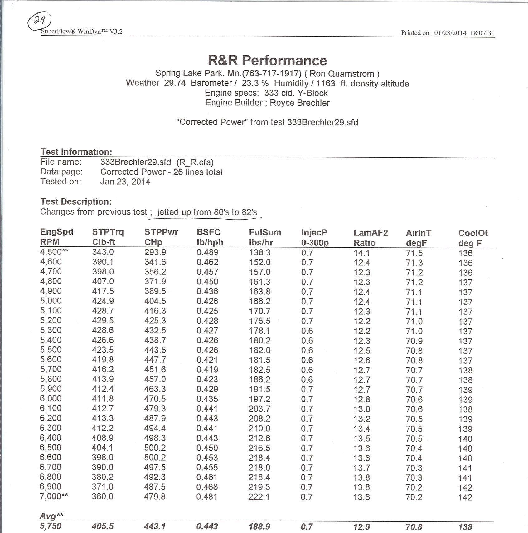

In a recent dyno test this intake made 15 ft lb more ave torque and 12 more ave hp that a ported Mummert intake. Jerry said he would build a free one for anybody who could get it under the hood of a 56 Bird.

Royce. Thanks for sharing. Looks good. I like the fact that all the runner entries are the same distance under the carbs. That goes a long way in getting the torque numbers up versus the port entries being staggered.

Pretty impressive HP numbers from 333 ci. I think i see one of Duntov's ideas in Jerry's hand.
