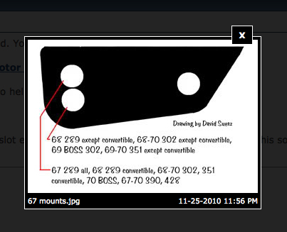

i think they are 67 289 only. 67 convertible, 67-70 big block, 68 289 convertible, 68-70 302, 351W convertible
maybe add an imaginary line of what got trimmed off to better help id the upper hole distance.

seems 67 was one year only change.
of course thats the year i have. and also finding the rubber mounts are single year also.
i may opt for 68 units and make life easier and in my case, 1/2" higher.
