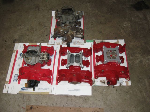

Here’s a group of YBlock 2X4 intakes being used for a dyno test. This grouping includes the1956 Ford, 1957 Ford, Edelbrock FM255’s and 257’s, Edmunds, Fenton, Hogans, and the somewhat rare Merc manifold.
http://forums.y-blocksforever.com/Uploads/Images/a88f4551-e0ae-4f79-a735-49f1.jpg

I'm assuming you lock a BIG dog in the shop at night? You are holding on to some real valuables there. Chuck

Thank you Ted. Now when my wife tells me I should get rid of some of that j*** (I can't bear to type her word) I can show her your photo and let her know "I'm not even close!"
Chuck, i think Teds dogs name is Smith & Wesson.
