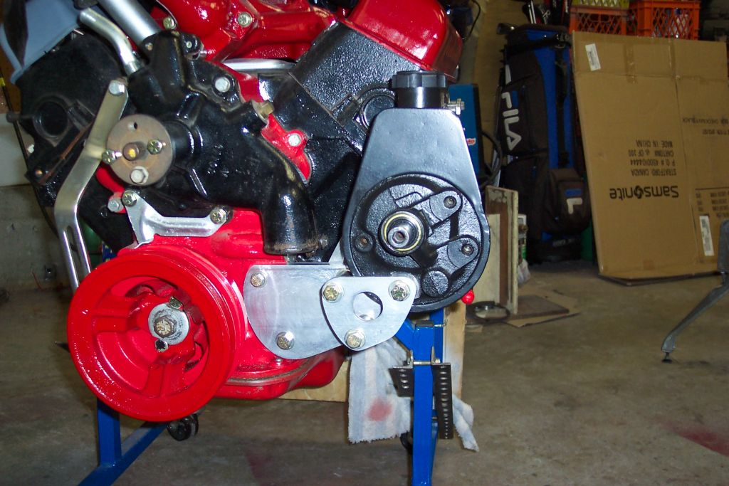

Moonshadow, they weld a plate to it that matches the Ford bolt pattern. I was going to mention the alternative but ctfortner has already posted it. Of course I found this all out after I purchased a box from Borgeson. If anyone decides to do this don't buy the steering pump from Borgeson, use a Cardone 20-6800 - $58 bucks from Amazon. Don't buy the bracket either you can easily fab your own.
