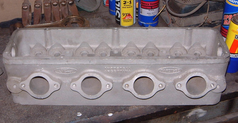

Davis, these argy windsor heads would use their own intake as intake ports are same as windsor, i.e spread apart ! years back when we all became aware these heads existed, one of the y blockers reported in the magazine of visiting Argentina and was given a set of these heads by mechanic there, if i recall ted or others were of the opinion these windsor heads wouldnt flow any better than a y block head, so apart from a few fantising about testing a set of these with the view of owning any is a bit of a pipe dream. But would be good talking point in car. To add to it subject ,"Industria Argentina" who cast all the ford engine parts etc for many years also made a few alloy heads for racing back in 57 and then cast iron versions for their trucks there and were often just referred to as 292 truck heads. There was a cover shot and article in hotrod magazine years back of weslake style cast iron 292 headed engine in hotrod. They both add an interesting dimension to our favourite engine. Regards aussie bill.
