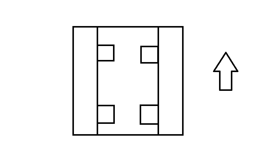

it can be built as a 'combo'
run four manifolds for engine than can run 4 2 bbl's
or bolt on 'bridges' with one 2 bbl each in center
for engines can only use that much carb
note: the 'bridge' is like this attachment
get rid of middle carb, change 4 bbl to 2 bbl
and turn it upside down

more on building 4 intake manifolds
to fit on each pair of intake ports
1 manifold runners ought to be
'mail chute' shaped
straight down and curve to pair intake ports
2 carbs should all be forward facing
sideways is out because they weren't built
to slosh sideways
3 milled face around intake ports on our heads ( BT1E )
include outboard boltholes for stock manifold but not inboard ones
inboard bolt holes are way over by heat riser passage
that makes things a little tricky
4 not dealing with cooling crossover now
which shares one bolt hole w/intake
